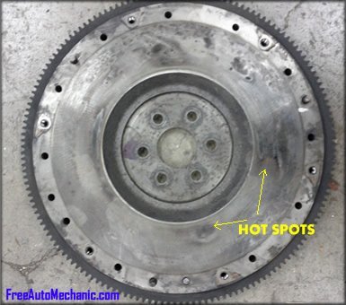

A flywheel has teeth that can be damaged similar to the flexplate but the flywheel's teeth can be removed. These teeth are know as the ring gear. If the teeth on the ring gear are damaged it should be replaced. Also the surface of the flywheel can be damaged caused from friction of the clutch plate material or lack of. If any groves are noticed the fly wheel should be resurfaced before installation. The last thing to look for are what are know as "Hot Spots" that will cause the clutch to chatter or vibrate when using it. This is a slight warpage and can be visually seen by slight discoloration on the flywheel surface. The color of the surface will have a purplish tint in areas where the surface has gotten hot. This can be caused by hot rodding and or riding the clutch.
