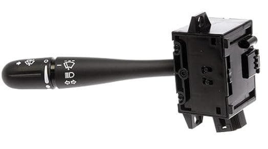

The most common cause for this issue falls on a faulty multi-function switch. This switch receives a lot of use and therefore tends to wear out quickly. Here is the exact fit part required for replacement.

2005 dodge caravan multifunction switch
Multi-Function Switch Replacement
REMOVAL
  1. Disconnect and isolate battery negative cable.
  2. Remove upper and lower steering column shrouds.
  3. Disconnect wire connector from back of multi-function switch.
  4. Remove screws holding multi-function switch to steering column adapter collar.
  5. Remove the multi-function switch.
INSTALLATION
  1. Position the switch on to the steering column.
  2. Install the two retaining screws.
  3. Connect the wire harness connector.
  4. Install the upper and lower steering column shrouds.
  5. Connect the battery negative cable.
