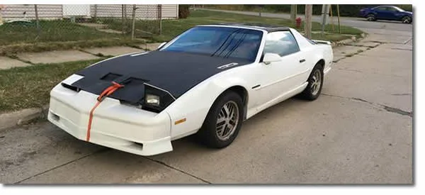

The engine is over heating and the mechanics don’t know why. New heads, water pump, thermostat and sensors, etc. Over heats almost immediately. We are all stumped and need help. Thank you. 305 engine 5.0L.
