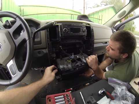

The AC will not blow during the heat of the day. Once it cools off it works just fine. When it doesn’t blow air out the vents you can hear the motor going but no air.
The most common reason for this is a failing mode door actuator.
