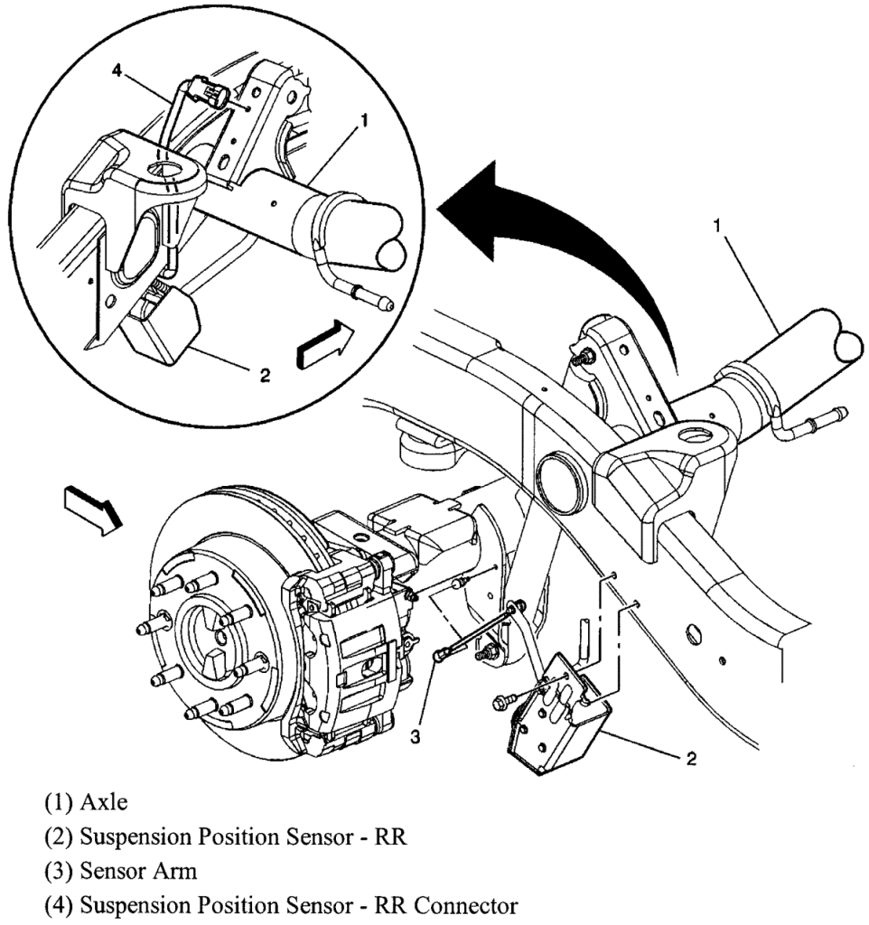

2005-caddilac-escalade-suspension
Electronic Suspension Control
The Electronic Suspension Control (ESC)/Real Time Damping (RTD) system, is fully automatic and uses a computer controller to continuously monitor vehicle speed, wheel to body position, lift/dive and steering position of the vehicle. The controller then sends signals to each damper to independently adjust the damping level. The ESC/RTD system consists of a control module, four dampers and four position sensors.
The ESC/RTD system has an integrated Automatic Level Control (ALC) system. The ALC consists of the rear automatic level control dampers and the automatic level control air compressor. The ESC/RTD system also interacts with the Tow/Haul switch. When engaged, the Tow/Haul mode will provide additional control of the dampers.

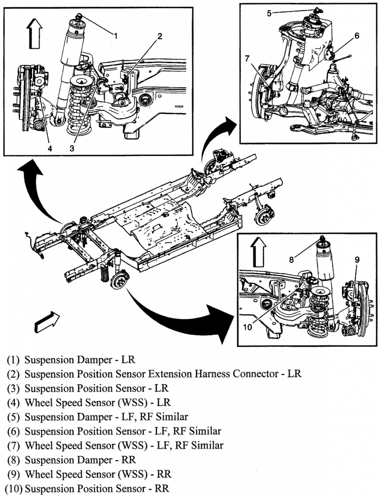

2005-caddilac-escalade-suspension-electrical-connectors
