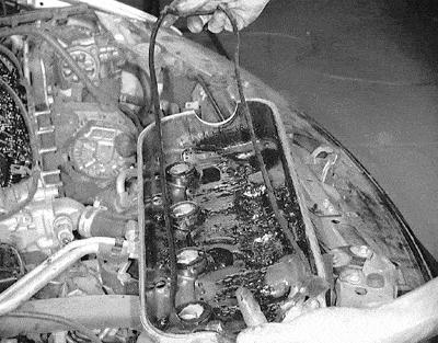

- Carefully lift the cover off the cylinder head. Use care to not loose the sealing grommets when lifting the cover. Place the cover upright in a clean, protected area. If the cover is stuck onto the cylinder head, using a suitable prytool carefully pry the cover upward at the corners. Move each corner no more than a 1/16 inch at a time.

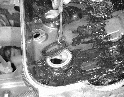

Use a pick tool to carefully remove the valve cover-to-spark plug tube grommets
Carefully remove and inspect the valve cover gasket and replace it if it is damaged

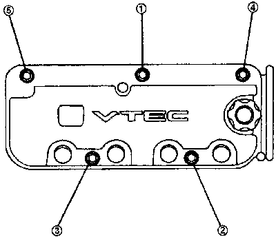

Install the valve cover properly in the cylinder head groove-1996 Accord shown

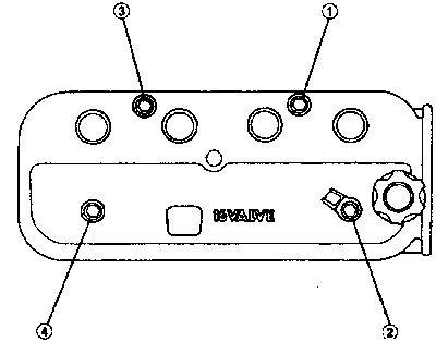

Non-VTEC engine valve cover torque sequence-non-VTEC 2.2L engines

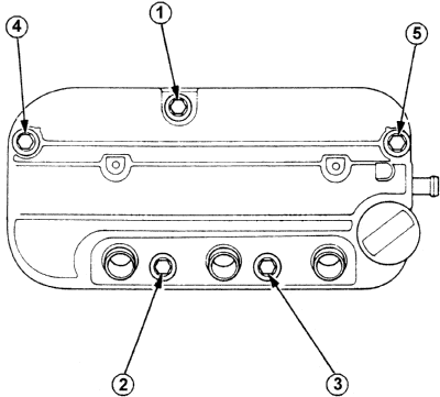

Rocker arm (valve) cover torque sequence-non-VTEC 2.2L engines
Tighten the rocker arm (valve) cover bolts in the sequence shown-3.0L engine

- Inspect the rubber valve cover gasket, the sealing grommets, and the seal around the spark plug holes. If the gasket or seals are brittle, cracked or damaged, replace them. If the old gasket and seals are not worn or damaged they can be reused once cleaned.

- Install the grommets if removed, and tighten the valve cover fasteners from the inside out evenly in three steps. For the 2.2L and 3.0L engines, tighten the retainers in the sequence shown in the accompanying figures. Tighten the valve cover fastener, as follows:
- 4-cylinder engines: to 86 inch lbs. (9.8 Nm).
- 3.0L engine: 108 inch lbs. (12 Nm)
