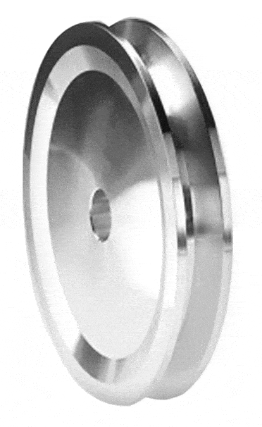

There doesn’t seem to be a factory fit high performance alternator that will fit the factory mounts. There are a couple options for this. Purchase an Overdrive pulley and see if it takes care of your needed power supply issues. The factory out put is 110 amps. The Overdrive pulley sold by Carid advertises 50% increase.
overdrive-pulley
