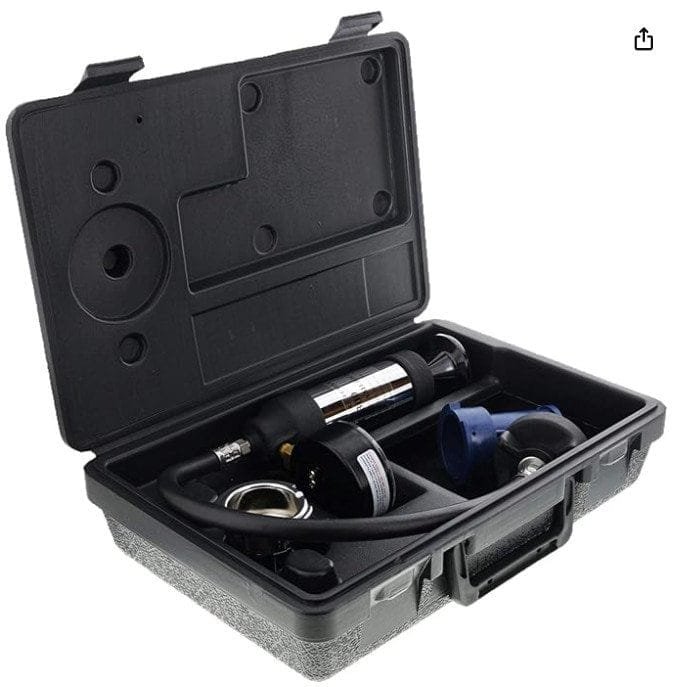

Cooling System Pressure Tester
cooling system pressure testerShop Automotive
Purchase Cooling System Pressure Testing Kit
