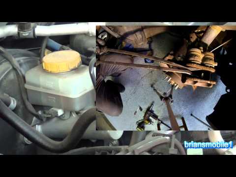

The brakes operate with a sealed hydraulic system. You do not need to add fluid. When the pistons of the caliper move and the brake pads wear down more fluid is needed to maintain there use. Once they wear down so far the light comes on. When you replace the brake pads the calipers pistons are moved back in requiring less fluid. When the pistons are pressed in to accommodate the new pads, the brake fluid level rises back to level.
This is Why Your BRAKE Light is ON
