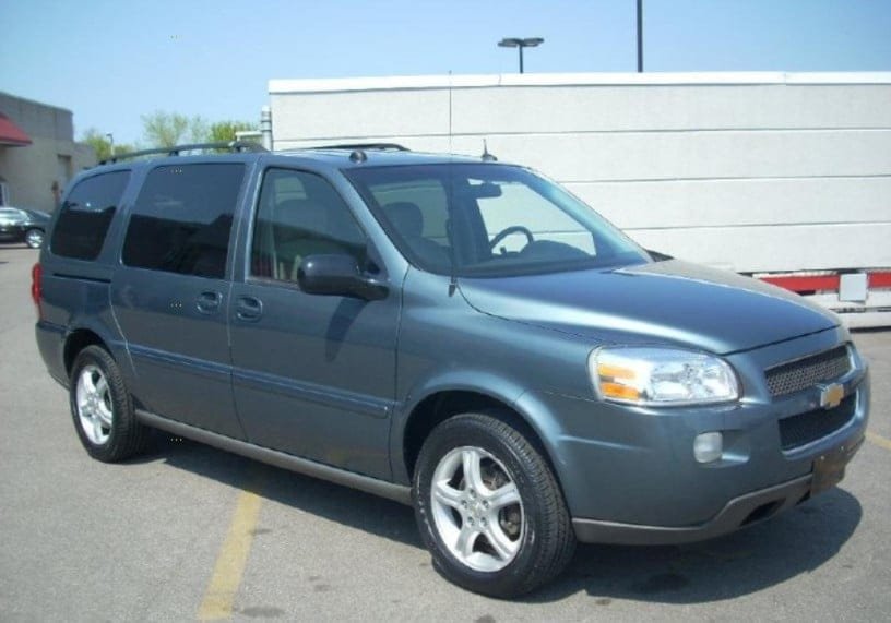

Why does ABS light come on sometimes when I’m driving on bare pavement? I have a 2005 Chevy Uplander.
ABS light comes on when on dry pavement
This is common when the front ABS speed sensors are located in the hub bearings. In your case the 2005 Chevy Uplander hub bearings have internal speed sensors.
