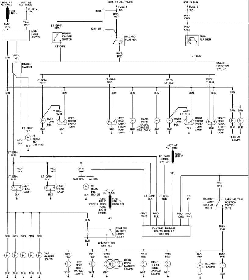

AAMO spliced in new neutral switch to old connector -cars lights were fine before now turn signal blows fuse and the battery was 12.5 when brought in and now was 5 volts
Unless wired different from factory the turn signal fuse is on a completely separate circuit than the neutral switch. Use the wiring diagram provided below to gain a better idea of how the circuit works.

1989 Ford Bronco Turn Signal Wiring Diagram
