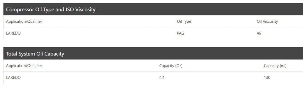

Probably not doing anything wrong. Working on your air conditioning can be difficult even for an advanced mechanic. I hope you added in some PAG oil as required. 24 oz of R134a seems a bit high. Let me look it up in the manual to see how much it is supposed to hold. Overfilling the system can cause an issue as well. Manual states 24 oz. It also states you need 4.4 oz. of PAG-46 oil. I do not think this is your issue though.
