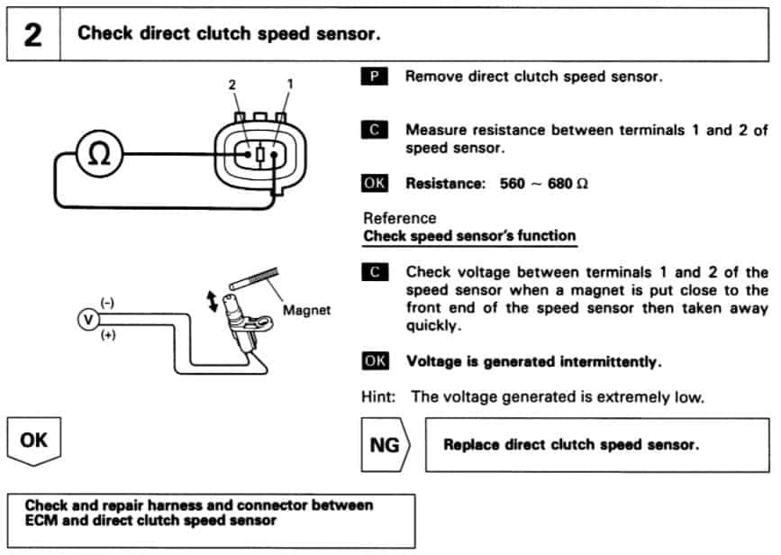

I’m getting an error code p1705 that says a VSS trans speed sensor is at fault. I don’t know which one it is. So I pulled the sensor with 3 wires coming out of the top. Blue, pink, blue&red How can I test it to see if it is the faulty sensor? Its a 1999 Toyota Camry 3.0.
Toyota Code P1705
NC2 Revolution Sensor Circuit Malfunction/Direct Clutch Speed Sensor (A541E Transaxle)
Code P1705 Circuit Description
This sensor detects the rotation speed of the direct clutch drum. By comparing the Direct clutch speed signal and the vehicle speed sensor signal, the ECM detects the shift timing of the gears and appropriately controls the engine torque and hydraulic pressure in response to various conditions, thus performing smooth gear shifting.
