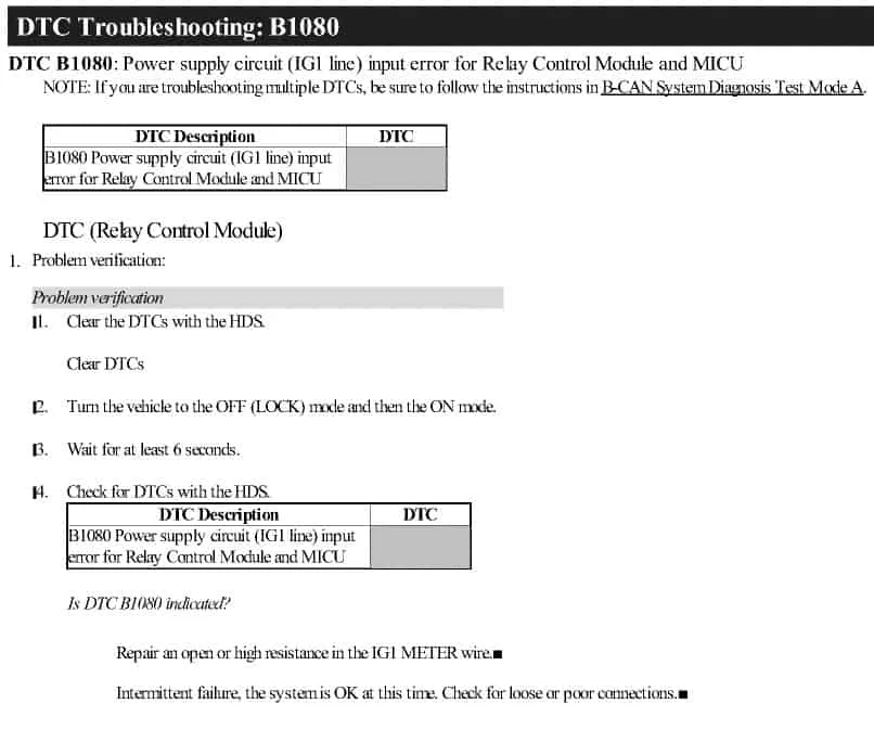

Didn’t find anything on DTC 27 or PA11. I was able to locate some information on DTC B1080. Here is what I found covering the code.
Honda Code B1080
Power Supply Circuit (IG1 Line) Input Error for Relay Control Module And MICU
