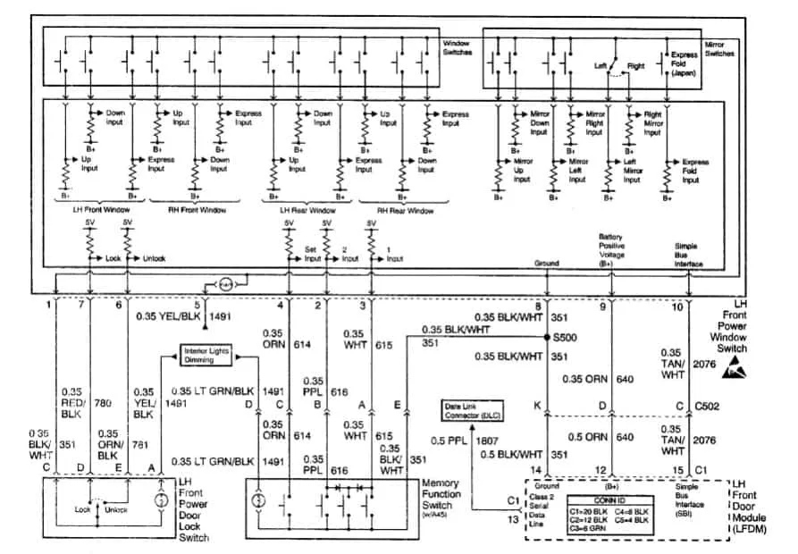

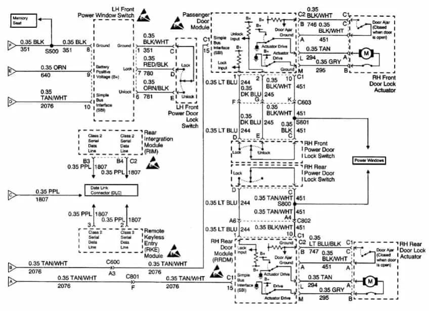

Unable to control windows, mirror or lock switch from driver door console.
What are the possibilities?
The most common reason would be improper voltage. So this could be from brittle, broken wiring. Most likely in the wiring harness at the door jam. This is where most wiring harnesses show the most wear. The cause is from the door opening and closing over the last 20+ years.
Power Windows Wiring Diagram
Power Door Mirrors Wiring Diagram
