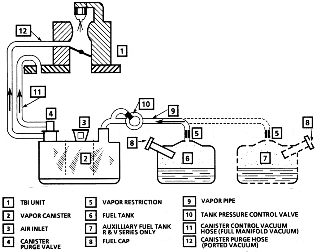

Your EVAP canister(VAPOR CANISTER) is full and will need to be replaced. This is cause by trying to top off the tank once the pump clicks off on its own. Trying to get that last little bit extra is what causes it.
