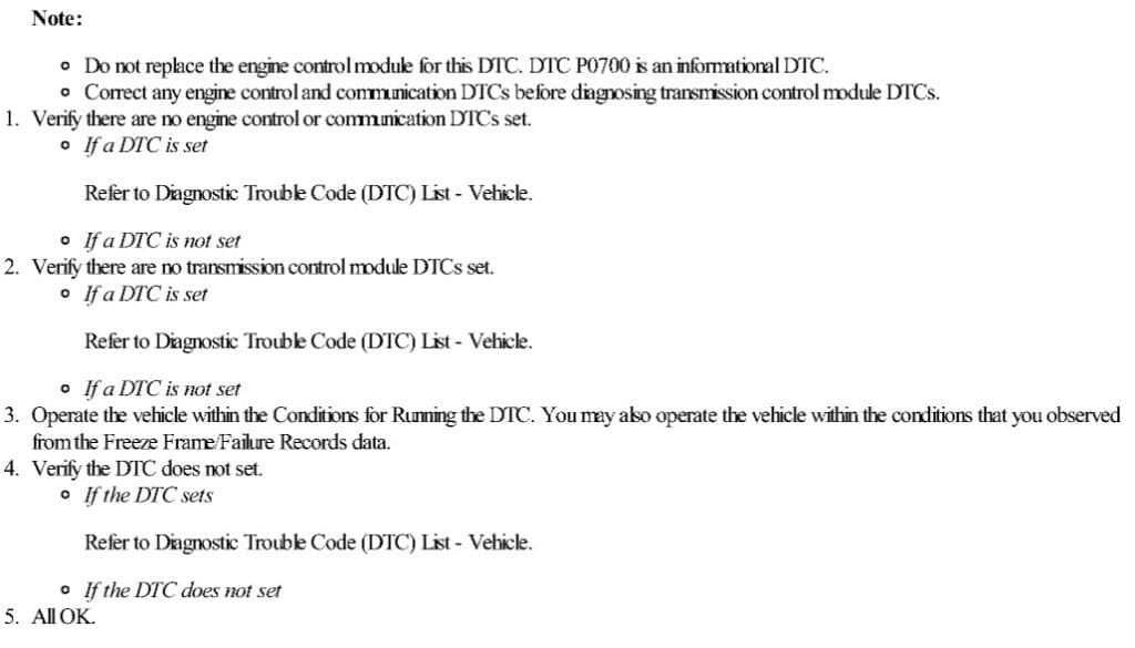

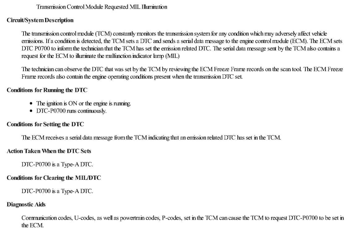

In short, this is a BASIC code. The use of a computer diagnostic equipment that is capable of pulling the U-codes may be needed to narrow down the issue with the transmission.
Code P0700

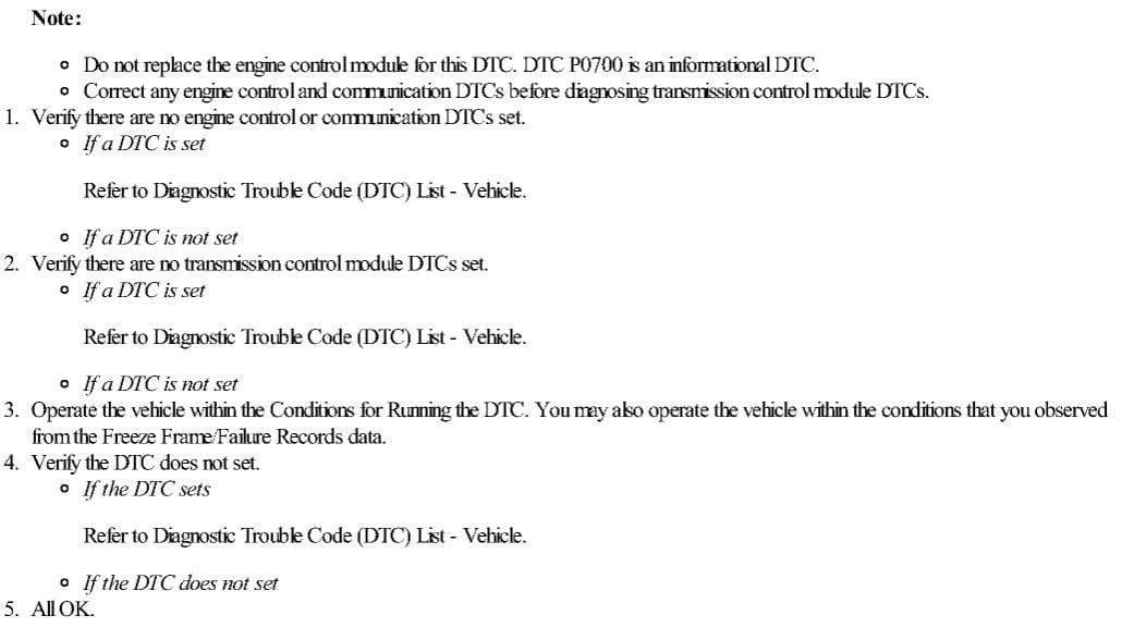

Circuit/System Verification
