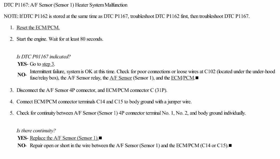

This is the error code: P1167
The ecu is reporting 0.6v to 0.7v on the first O2 sensor and its way to stable, the second O2 sensor is fluctuating all over the place even when warm.
The car has been diagnosed by 6 different garages and none have found the problem.
Possible fixes that have been tested
Faulty air/fuel ratio sensor 1 (has been changed by oem honda part no change)
Faulty heater circuit (has been tested and found to be working normally)
Blown fuse #6 (15A) (has been cheked again by myself today)
Loose or corroded connections (have been cheked to)
Faulty PCM ( nobody seems to know how to diagnose the pcm/ecu)
Thanks in advance, im stumped at the moment (i have a car mechanic diploma but i work in IT soooo im not the greatest 🙂
Here is what the Auto Repair Manual Suggests for Honda Code P1167.
