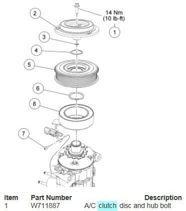

My question has to do with a/c clutch on the compressor. it fell off. AC Clutch Inspection shows bolt holding the clutch in place broke off with some of it lodged in the compressor. It had to break off for a reason. Is the compressor shaft stuck so that it won’t turn. or just a bad bolt?
AC Compressor Clutch Failure
In most cases the air conditioning systems AC clutch failure is caused from bearing failure. When the bearings start to fail it creates excessive heat. The excessive heat may damage other parts of the compressor. This can cause internal o-rings to become damaged as well. My automotive advice is to replace the entire compressor assembly.
